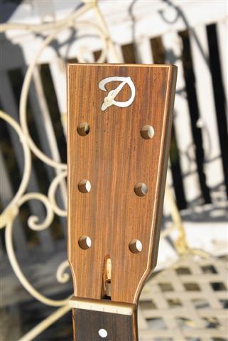

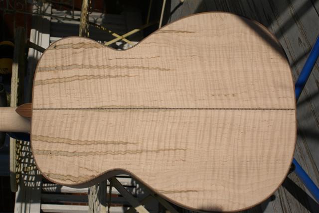

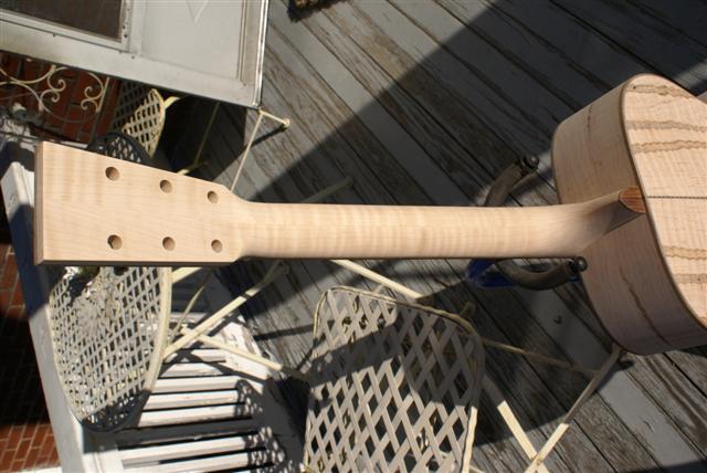

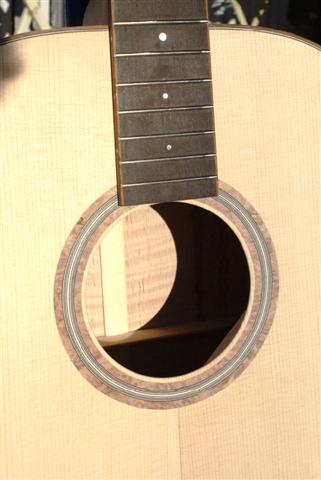

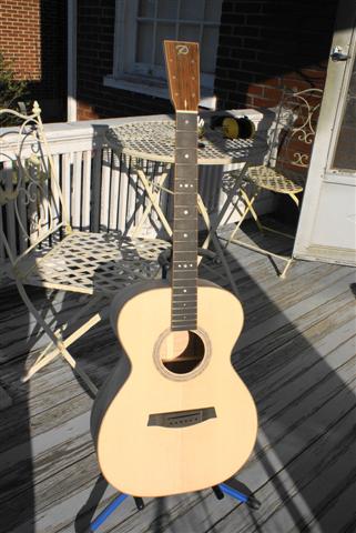

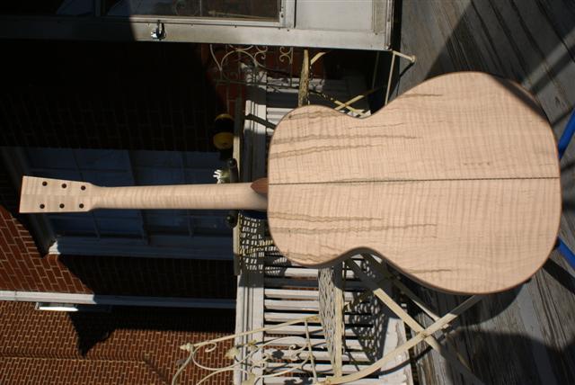

Hello boys and girls,
I just finished placing the bridge on this guitar and getting it ready for finish. I will start spraying tomorrow. This is an OM with a 25.4 scale guitar. The specs are:
Sitka Spruce Top
Figured/Spalted Maple Back and Sides
Cocobolo Binding on body,fingerboard,and headstock
Ebony Bridge and Fingerboard
Maple Burl rosette with b/w/b/w/w/b/w/b inlay
Mother of Pearl Inlay on Headstock and FB dots
Maple two piece neck.
I think she is going to sound real nice so everyone keep their fingers crossed. Thanks for looking and all advice/comments/criticisms are welcomed.
Homeboy
P.S.- Thanks go to Steve Kinnaird for the spalted maple idea. I saw his guitar at the GAL convention and decided to go for it. This wood was bought from a local lumber yard for 2.50 a board foot. I was going to build a table with it until I saw Steve's guitar. Another thanks goes out to everyone who replied to my query on how to fill the worm holes in the wood. I went with the consensus advice and filled with ebony dust and superglue.Homeboy39071.6745949074

Rod- I have not strung it up yet. I generally dont string up a guitar until I am done with the finish. Do most people string the guitar in the white?
HomeboyHomeboy39071.6781712963

Homeboy, how much harder is it to finish a guitar with the bridge attached than with it off?
Looking forward to seeing yours finished.
PostPosted: Wed Dec 20, 2006 8:29 am
Posts: 194
Lillian,
The bridge is just on the top with the aid of two positioning pins. I have taken it off and taped the top up over the place where the bridge and fingerboard extension will. I glue it on after I finish the guitar.
Homeboy
Most people don't string it up before the finish, but I don't think most people put the bridge, neck and nut on before finishing either. That would be tooooo tempting to just throw a saddle and tuners on and play it a bit.
I like many others don't attach the neck or bridge till the finish is all done.Rod True39071.687650463
